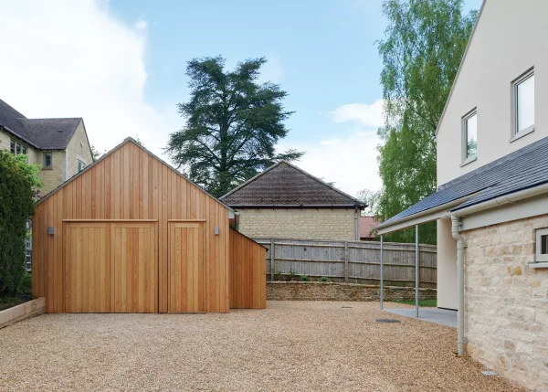

I’ve just completed a new 4 flat build with some external cedar wood cladding on and wondered what (if any?) the best treatment is against UV and damp damage?
